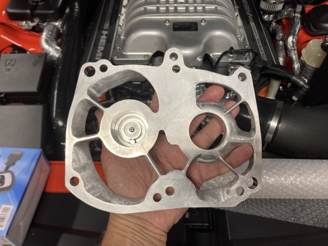

Yes, 25.38 to be exact with my hand ported 2.7 snout and 105 TB, has my custom billet 2.7 inlet plate with oiled bearing, the thing is singing but staying happy so far!! Have to try the SDG snout and NW 108 TB someday.

Man that’s moving air! Wonder what mine makes no (just a dinky 2.4) pretty sure I’m maxing out the stock map sensors
