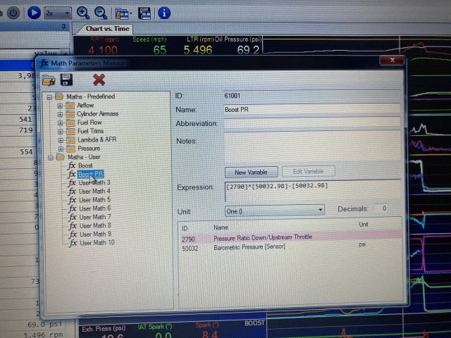

So now I’m testing a 2.7 IHI blower with my custom billet oil lubed front plate and same HP Tuners log channels file is telling me MAP is around 24 psi but PR of 2.75-2.80 is saying MAP is more like 25-26 psi at 14.5 Baro. I’m going to hook up same liquid filled gauge to the blower lid again and measure actual next run but how do I get HP T to calculate and display MAP correctly based on PR and Baro pressure?

On my 170 I log MAP, Sensed MAP, Pressure Ratio, Aircharge, and have a custom PID called "BOOST" in chart data. I also log Barometric pressure as it's needed to calculate actual pressure in most cases. They're all with in 1psi.
I think @fumanchu182 gave me a tip on setting up the "BOOST" PID since it's custom and actually reads one of the MAP sensors (from memory) and subtracts BARO from it.

That's what I did, only to get a little more accuracy I used the formula:
Pressure Ratio * Barometric pressure - Barometric pressure

@Speedy! What symbol do you use for Multiply the Asterix? * ?
Here’s it by IMAP
6,910
17,829
Yep asterisk

@Speedy! can you post a screen shot of your math page for boost based or PR? I can’t get mine to work that way.
See mine, look right or wrong PR channel?

@Speedy! I found the PR pid but I ca not find the Baro pid you used, I used sensor. Where did you find the Baro pid you used? I’d like to be comparing to a same calculation as others may be using to get an idea how this 2.7 is doing boost wise with my custom plate on it and hand ported snout with a 105 TB
Boost using above pids. 25 psi avg on the pull not bad for a +10 lower 2.74 clutched upper combo with a well used belt. From watching the boost pid I think there’s a hair of belt slip going on, may install a new belt before dyno visit.

You should be able to search for the PID by number.
