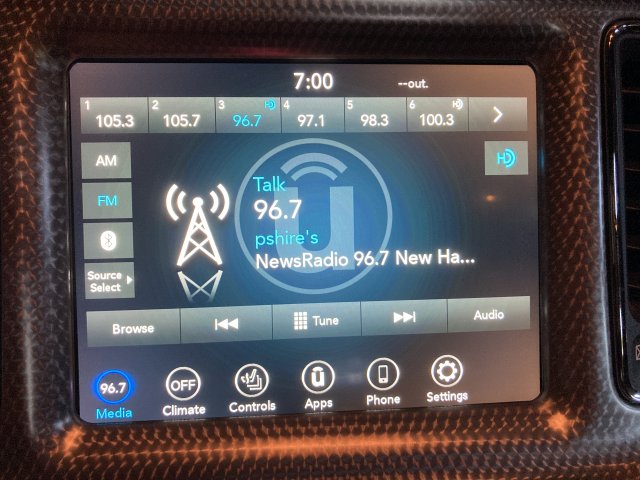

Middle of summer and the vented seats won't work, neither seat, heat and steering wheel heat all non functional. The screen acknowledges the touch, it beeps, but the heat/vents don't turn on. Fuse 51 is good. I disconnected the battery to reset whatever, and they still don't work. Not only that, I'm now getting the black and blue screen instead of the normal screen.
The first question is, how do you get the normal screen back.
Second is, does anyone have ideas about the seat controls? Still under the 3/36, have an appointment Friday, but I would really rather to not let them touch it.

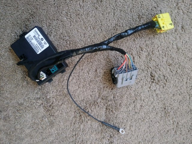

The module for the vented seats is under the Pass seat. Make sure BOTH connectors are fully engauged. I am sure the module power is fused. I would check the ledger really carefully and check any fuse that might feed this. Also the car actually has to be running for that system to work.

To force a radio reset and get the SRT Pages back you can hold the Power and Tune buttons in by depressing them for 30 seconds.

My guess is the Pass side Grey connector is not HOME.

Fixed! Thanks, yes it was the gray connector. I didn't latch it, the latch cams the connector in the last bit, and obviously the pins were not all in contact when unlatched.
And the proper screen came back.

It's just the physical location of the module under the Pass seat controls the system. Has nothing to do with programming.
Just so you know the Memory seat module that also controls the power steering column is under the Drivers seat.

I make a setup to bypass the airbag/seatbelt light and re enable the Heated & Vented Seats. I do not sell many because it's really expensive. If you run that way a lot it might be worth it. 0613201838a.jpg
