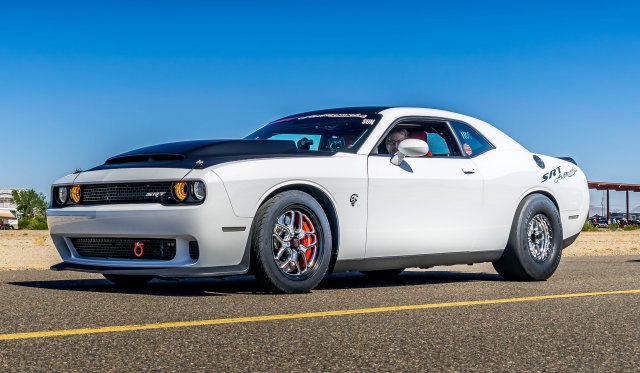

It has the 1320 springs in this picture. It sits with a little bit of a nose down rake now but the rear tires are 30.5 tall so that accounts for that. 033DF2AC-A323-4401-B68D-CEBD76A8D671.jpeg

It has the 1320 springs in this picture. It sits with a little bit of a nose down rake now but the rear tires are 30.5 tall so that accounts for that. View attachment 7634
Thanks, I wonder how they would sit on stock tires. I run 305s MT ET Rs they are 28" tall (IIRC), and eventually I may run the 315s, which are 29.5" tall. I'm wondering if a shorter tire in the rear like the 305s, might make the rear sag a little. I don't care if it has some rake to it, but I don't like the front sitting higher than the rear (Demon Killers), or the 4x4 look of the Demon OEMs. Looks really good! I know you are far from stock, but you have any 60ft data? More consistent launches? Better 60fts? Appreciate the info!

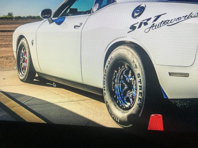

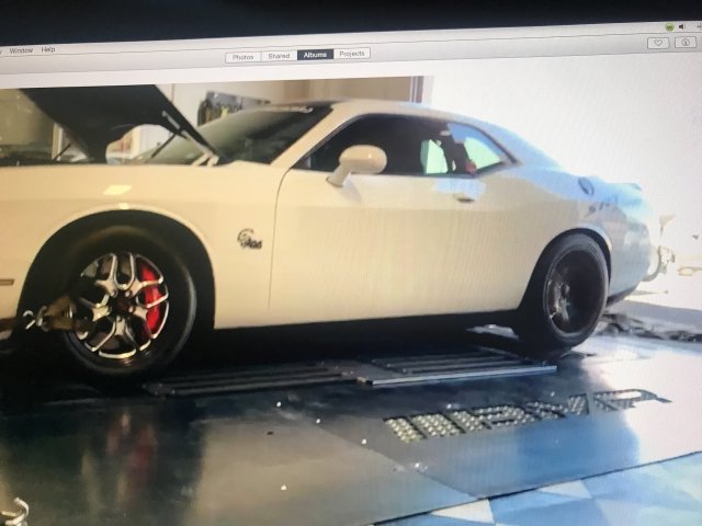

Here’s a screen shot of the car on the dyno. It’s from a video (I can’t post those here). It’s with a stock 20” wheel and tire on the rear. The fronts are 28’s also and the car sits level front and rear with the 1320 springs. I do think they lower the car a little all around though (probably due to the increased weight of the Hellcat) because they noticeably changed the camber on the front. I will also add a picture where if you look you can see that the tops of the tire are now tipped in due to this. The only way to “fix” that is by adjusting the cradle and I didn’t do that because I think it will steer better in a straight line under acceleration the way it is. D450663A-346F-4672-9F85-1AE637B8368F.jpeg DD331D87-A1A2-41E7-B8E9-3BBB77C09FDE.jpeg

That looks like they sit like the OEM Demon springs do, looks like it raised the car height quite a bit! Do you have a before picture of same wheel/tire setup? I appreciate this. Hopefully it will help people decide what springs to get, now that there are 4 options lol.
