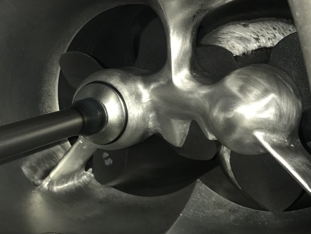

Rattles like a bitch at idle, but when pulling the lid and looking at the rotors they look ok so Whipples response currently is it's working as designed, is designed as a race blower with no care to NVH so the idle rattle is normal and to send it. Not super happy about it and I also wish I went twin turbo but I'll keep my eye on it and see.

Can u post a video of what that sounds like? I have not heard any rattle at idle with mine yet. Has it been rattling the whole time or after uve made some hard pulls?

That's a real quick video of it rattling right out of the box, before the car was even driven. It sounds worse now, I would take another video of it but the car is across the country at my friends shop for a TH400.
The blower hits hard, and I like it. Aside from the rattling, it's just annoying. Having people at the track ask me what's wrong with the car or yelling at you to shut it off because they think there's a catastrophic failure is also annoying, lol.
Whipple does seem to be trying to resolve the rattling issues and assured me if the blower ended up damaged in any way it would be warrantied so I'm not super concerned about it. As long as nothing goes that wipes out the engine anyway.
EDIT: I lied. Here's another video of it at the track after a guy in the pits next to me told me to "SHUT IT DOWN, SOMETHINGS WRONG!"

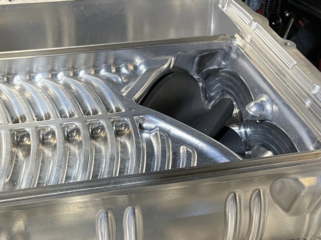

Check the rotors. Two easy ways to do that. Pull the lid to see the rear or pull the throttle body to check the front (easiest). The original billet version in the first picture. It’s got 30 passes plus dyno time on it now and makes a ton of power. Over 1400whp at 3000’ elevation thru a T400. It’s still in perfect condition. The second picture is thru the front of another that started eating itself. We’ve found that they don’t like rpm. Anything smaller than a 3.50 pulley is a problem. Stay tuned. It’s a saga. 😂 IMG_0317.jpeg IMG_4982.jpeg

Check the rotors. Two easy ways to do that. Pull the lid to see the rear and pull the throttle body to check the front. The original billet version in the first picture. It’s got 30 passes plus dyno time on it now and makes a ton of power. Over 1400whp at 3000’ elevation thru a T400. It’s still in perfect condition. The second picture is thru the front of another that started eating itself. We’ve found that they don’t like rpm. Anything smaller than a 3.50 pulley is a problem. Stay tuned. It’s a saga. 😂 View attachment 132919 View attachment 132920

Best and easiest way is to just pop the throttle body off and look at the rotors. If they have touched, open a case with Whipple they will take care of you.
