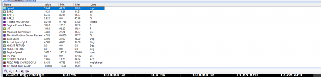

I just did a pull the car read 17psi. DA is +850
Speedy- I just looked at pRatio and it reads 2.190 for the pull I just did. I'll have to find a good PRatio calculator
I'll have to add the Air Charge PID I thought I had it but I guess not.

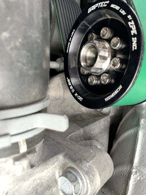

You double check the pulley size?

Yep checked it a few times before install.

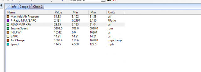

Here is air charge. Is that low?
6,780
17,438
#50
It's not low, but mine will see 2000+ in good air as a reference point. I'd say things are normal.

Sounds good da is around 800 so pretty good air. Thanks for the feed back.
