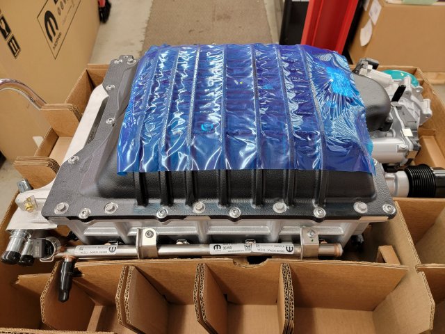

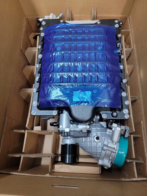

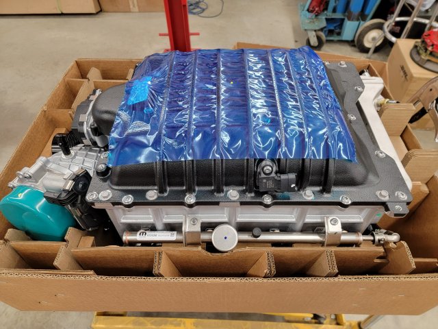

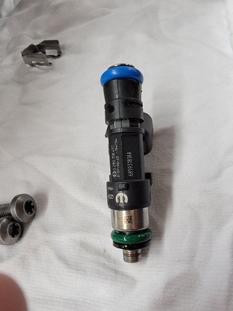

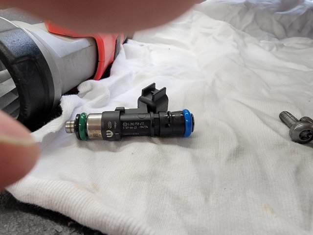

FYI The fuel injector used on the Demon 170 is the same injector shown as used on the Redeye and Super Stock, part # 6859318AA
*** can anyone can confirm this 2023 part number does in fact cross over to the 2023 redeye/superstock ?
The Redeye injector is 68593181AA so not sure if he left out the 1 at the end in his post or it is a different part number
You have the correct Part # 68593181AA. The other fellow left out the #1 at the end. That is the injector that is used in the Demon 170. I have a complete D170 3.0L IHI twin screw straight from the factory and removed a injector to confirm your info. 20240428_134824.jpg 20240428_134901.jpg 20240419_100658.jpg 20240419_175149.jpg 20240419_175213.jpg 20240419_175238.jpg 20240419_175308.jpg
DemonSRT
#1457
561
1,763
Kawartha Lakes
From the info I received on Injectors.
2015-20 Hellcat's used 68170238AB
2021-23 Hellcat's used 53011614AA
Includes the TRX's & Durango's up to 2024
2018 Demon, 2019-23 Redeye's & 2021-23 SS's used 5038838AA
2023 Demon 170 used 68593181AA which also used a Voltage Stabilizer with them.
