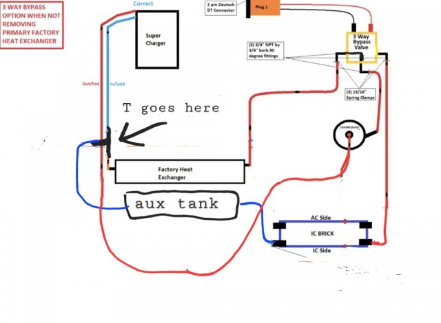

Hmm idk about that setup. How cold do you get
fubar569
#1073
1,335
1,925
Bradford
This setup should be no better or worse temperature wise. It just removes the chiller from the loop when running the factory HX so it's an either or operation.
I've seen mid 30's. I believe that's a function of an improper refrigerant charge though more than the flow loop itself. I know it isn't right since it self-drained at the track last year.

I read you guys post every night....I'm wanting to buy the chiller and get the aux. tank with the crash bumper.And I dont want to feel dumb but I'm 68 and this new stuff get the confused. I guess what I'm trying to say do I need to get the 3 way valve? And if I dont get the 3way valve I wont need to put a switch in the car....or am I reading to much into this. I plan on keeping the stock heat exchanger.
rookerrobert
#8615
359
239
Ridgeland
SC
2016 hellcat A8 and 2016 M6
The drag valve and the 3 way valve are to different things correct? or is the switch inside the car for the darg valve?
catdad
#869
136
189
Lake City
2019 Charger Hellcat
Yes 2 different things. Drag valve shuts off cabin ac. 3 way valve bypasses the heat exc. I use the 3 way vale in my system. When its hot in summer time it was taking a while to cool the cabin. I have 2 drag valves on mine, one works with the 3 way valve. If I use the heat exc it will shut off the chiller system. Once my cabin is cold I turn on the chiller and everything works great. Also in the winter time I rarely use the chiller. I over complicated my system but I like my ac ice cold.

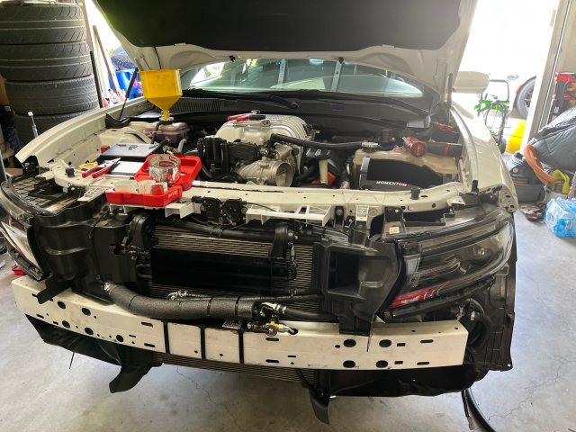

Just a few pics of my install 67425420720__A1A53747-C9F4-42CB-AE18-6E00EB1D1B36.jpg IMG_1212.jpg

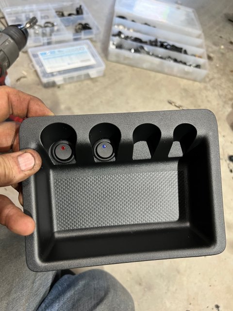

thats what I like not having to cut anything....the only thing I dont like is having to put a switch in my car I like to keep mine unchanged. But I'm still going with the ic chiller.I'll just hide the switch the best I can.
7,437
6,160
Thread Starter #260
You can put them inside your center console
