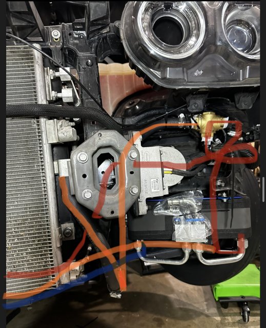

The big heat exchanger just reheats the fluid. This should be similar to how the 3 way bypass is used with both of them because the little one is plumbed into the big one. The little guy is just extra cooling - little heat exchanger, big heat exchanger, supercharger

The only time you'll use the regular radiator is when temps <= 60 and yes AN fittings save me a f'ton of time. I'm about to have AN fittings welded onto the supercharger or buy the Holley back plate and have them added there.

So this setup will flow fluid through the heat exhanger and then into the chiller when the switch is on
Those water manifold are stupid expensive I was eying them up a few people make them but they’re only 10an smh. Yeah, I had it because I don’t want to kill my compressor when it’s under 60 out. Would have made life a lot easier /cheaper not to use the valve. Introduced a lot of new leak points

which is why mine is on the left side, when on, it goes through the stock radiator in reverse flow (nothing to worry about) when off it routes past it and right to the chiller. the chiller is the single exit in mine and goes right to the reservoir tank no matter in the input is the radiator or a bypass.
Yep, that’s what mine does too just no tank and on the right side because of where they suggested to T in. I think it all does the same, only now I have 3 long lines

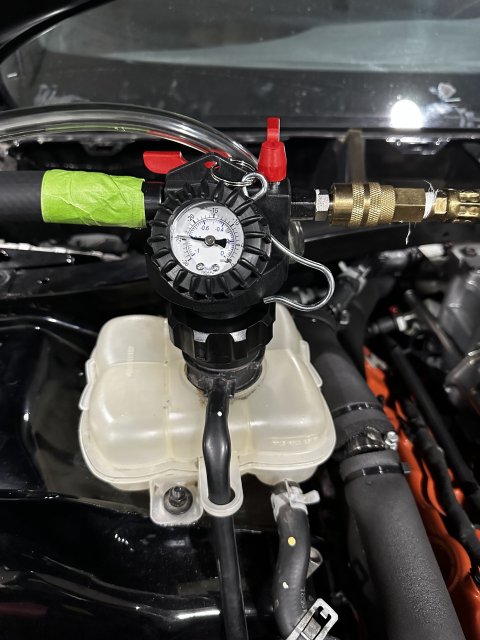

Psh at least yours was running. I’m getting a full evac and charge from the start. I’m more worried about my water fittings from the brick than the AC ones. Just finished wiring, I’m going to vacuum fill the coolant this evening and then the car goes to have Freon recover and then charge after I do the lines (they’re going to hold onto my refrigerant for a few days). I still have to do the AC lines unfortunately…

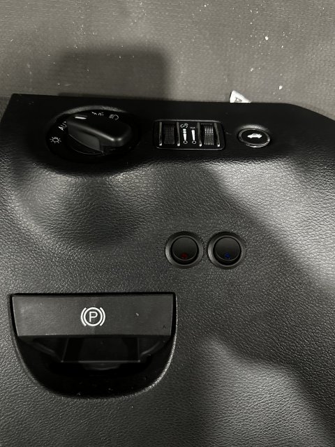

Thread Starter #120
Switches installed
