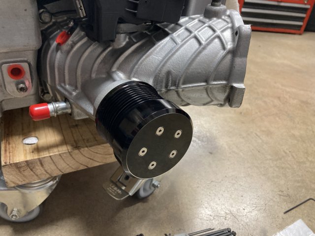

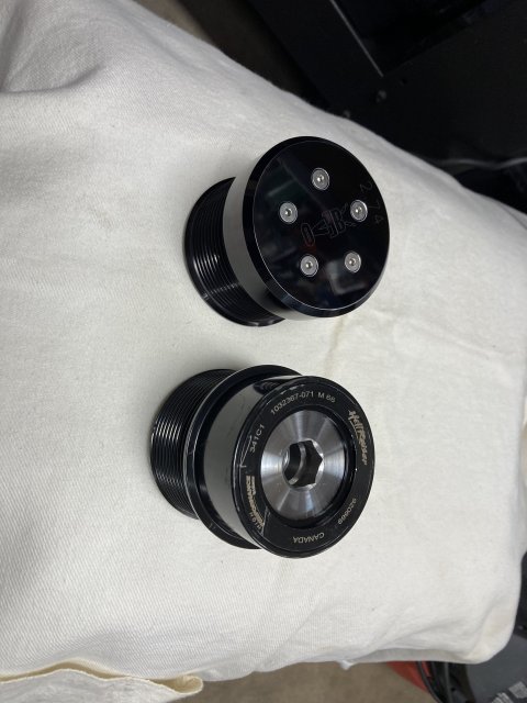

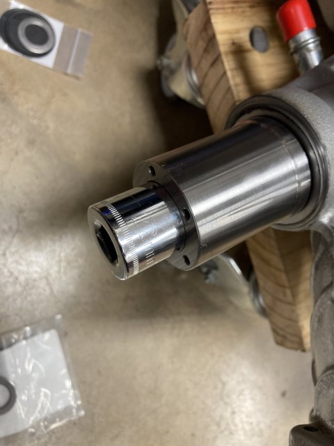

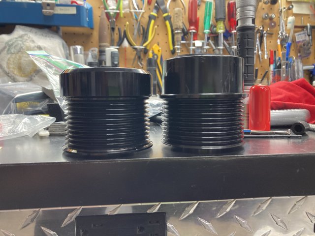

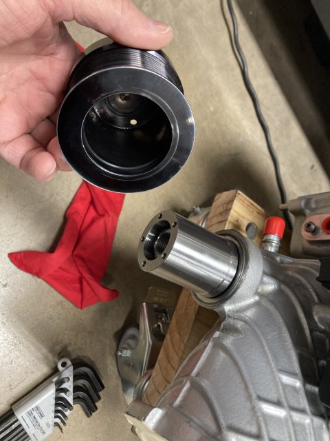

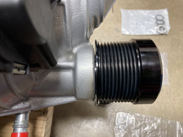

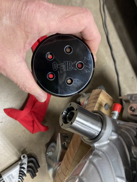

Satera Rings of Hell pulley arrived the other day. NICE piece!! It’s actually lighter and shorter than the Litens. It clutches instantly with about zero drag, in fact if you spin it on the shaft you cannot spin it back off the shaft by the pulley, it clutches instantly and so friction free the ring just spins on the hub and you have to put a socket on the hex to turn it off with your fingers. Give it a flip backwards and the lobes don’t even move!! It’s also a bit shorter which will make getting belts on and off between the stock Tstat housing easier. When my heads return from Thitek (on their way) and it’s back together the 2.4 is going back on instead of the Whipple, mainly to see if this totally free spinning pulley gets rid of the over rev I see between the 3-4 shift. It’s about the same cost as a Litens, except you can change rings easily and quickly, it’s advertised as 5x stronger then the Litens, and best of all comes with a 5 year no questions asked warranty!!
Can’t wait to give it a spin!!!

What's the price? Did I miss it?

Looks interesting. Love that you can swap rings.

The Metco on my car is like that. I'm surprised that they're not all like this.

Fixed pulleys like Metco are hard on the supercharger it's more difficult to have a decoupler pulley with interchangeable rings.

I've heard both sides of the story and at the end of the day, pushing these blowers are the main reason for their demise, in my opinion.

I haven't read anything that says that fixed pulley broke a supercharger. There are companies that rebuild superchargers that sell fixed pulleys. If they thought they damaged them I don't see them selling them. Superchargers have always had fixed pulleys until the Hellcat came out.
I have seen many decoupler pulleys break and damage the supercharger though

When I had the original tune done, I asked about a clutched pulley and I was told that the failure rate was way too high to justify using one. For what that's worth?

SRT wouldn't have gone through the extra work of using a decoupler pulley if a fixed pulley was just as good. Just sayin'.
No reason to use fixed pulleys on these. There are other options now.
I've been at the track and seen posts where fixed pulley cars had blower issues. Broken belts etc.
Finally, Mike shows in this very thread why fixed pulleys are a bad idea on these IHI units.
You guys go do what you want though, your car.
