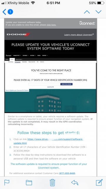

#56
I just received this email. Is this the 18.43.01 OTA update? It says if not updated it may result in GPS coordinates calculating incorrectly? FDAD7DF4-C750-4899-A138-74FBAE9EB002.jpeg
14,779
78,887
Thread Starter #57
Here's the TSB. Seems necessary for nav to function on older Mopars (pre '17 and some '17s).
