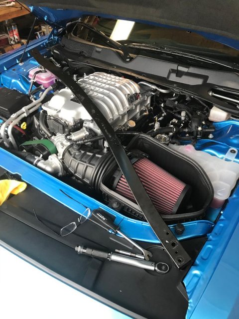

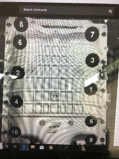

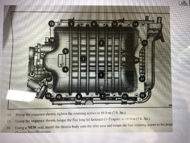

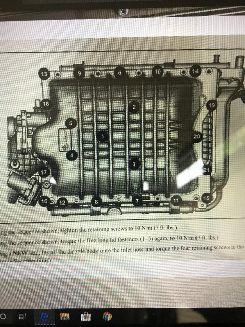

Here's some pics and some specs from "that other site". You should have a small inch pounds/ newton meter 1/4" drive torque wrench for the 7ft. lb. torx head bolts to be more accurate, and a 3/8" drive for the 22ft. lb. bolts. Basically you do all small T30 torx heads first to 7 l.bs, in sequence,(on top of the blower and around the perimeter 21X) then go up and down the sides, in sequence, for the 10 main bolts to 22 l.bs. (10X).
P.S. Your going to be swapping long and short sockets of the same size to get to the rear bolts. This all is easier than it may look.

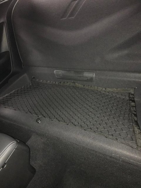

Removed all blaring, blinking, loud, obnoxious, and foolish looking interior warning stickers (5 total). Oh well, now no-one will ever know to not to glue themselves to the dashboard because in case of accident an exploding bag is going to come out of it like a grenade. They will also not know to not put a baby seat where there is no seat or anchor points, letting it bounce freely around inside the vehicle at every bump and turn. And that reckless action could damage the interior of car. Now I will have to inform other occupants before every ride. Good thing they also didn't have a "no removal" warning label" like the blankets and pillows or I could not have done it.
P.S. I needed a 1000 gigawatt LED spot light to get visible pics of the dark interior and under this light if you look closely you can see some evidence of said previous stickers at certain spots. Could care less those things were butt ugly and drove me crazy.

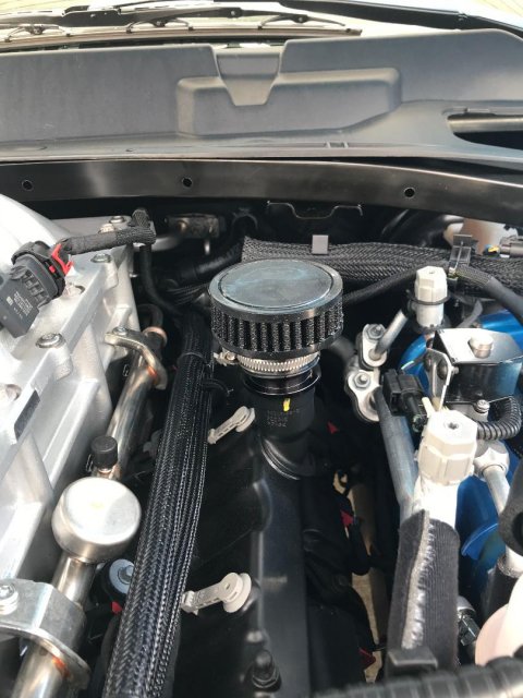

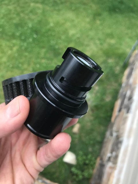

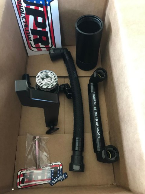

Put on a catch can and breather. YAWWWWN, I know. But wait.... there's more. Lol. First, I will say the UPR is more money but it is quality all the way and extremely well made. And I'm not easy to impress. BUT, it's not all rosy. Lines did not fit to my liking, were too bulky, and WAY overkill, so I used 1/2" fuel line and cut to EXACT length and raised the valve cover side with a 1/2" elbow to be perfectly square and level with fitting so now all quick disconnects disconnect with one two finger squeeze and pull..no binding.
ALSO, I could never figure out how guys were running "breathers" and not screwing up the PCV flow path. I kept saying "It's gonna pull atmosphere air from the breather not the crankcase". Then I went to UPR's website and saw it's really a BLOWOFF valve with a one way check ball. That's when I said "Ohhh" then..."Dohhh!" Also, super high quality piece.

I'd love a "how-to" on that, if you have one. Those labels seem pretty stuck
